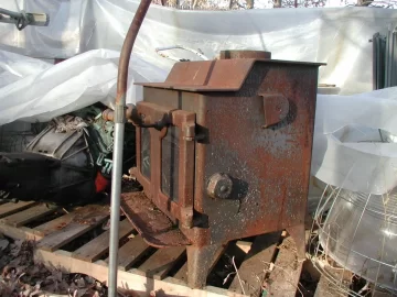

I have a 1200 square foot workshop that I am trying to heat with a Campagnar V-L0112 wood stove made by Les Poincons De Waterloo Inc. of Waterloo, Quebec, Canada. The shop is used sporadically and the fire allowed to burn out when not in use. In spite of trying various settings of the air inlets, it seems that the stove is not making as much heat as I think it should. The stove was a "rescue" and I have been unable to find a manual or any company information on it.
The shop is on a cement slab with well insulated walls and ceiling. The ceiling height is 10 feet. The usual temperature here when using the stove is 20 - 50 degrees Fahrenheit. It is only with the additional use of a gas fueled furnace that I am able to make the shop comfortable to work in.
The fire starts easily and once it gets going, I shut the doors. It seems that I am never able to get much more than about 250 degrees flue temperature measured with a gauge on the pipe and checked with an infrared heat gun. I have a kettle of water sitting on top of the stove which never boils, only lightly steams. I am burning mostly well seasoned oak and cherry.
The stove has an 8" single wall flu pipe which switches to a double wall pipe where it goes through the ceiling and roof and terminates with a cap and screen above the ridge of the building. Total length is about 30 feet. It is a straight run except for a slight offset to align the flue with the stove.
After reading many posts here I am wondering if the 8" flue pipe is too big and is allowing all the heat to escape before heating the stove itself. Would a flue pipe damper help keep the heat in and allow it to build up? Are there any other suggestions on what might make this work? I'd like to be able to start the fire and get on to other things with out a lot of tending.
Thanks for any help!

The stove does have what I will call a baffle in it about 4" down and extending about half way across the flue exit. The baffle is an enclosed space designed to heat air and exhaust through the openings on the upper part of the sides. It forces the heat from the fire towards the front of the stove before going up the flue. There are provisions for a fan to force air through the baffle but I do not have one installed. I have read that the forced air fans do not make much of a difference but have no experience with them.
I lit a fire today with four good sized pieces of oak and cherry. After about an hour, the flue temperature two feet up was about 280 degrees. Temperatures on the top of the stove near the flue were highest at about 385 degrees and dropped off to around 200 towards the edges. Sounds to me like the heat is going up the flue but I'll defer to those who have more experience. All of my fires have been loaded in the east-west configuration leaving room around the logs. I have read elsewhere others recommend a north-south loading configuration completely packing the fire box with wood. Thoughts?

The stove is running somewhat cool. With good dry wood I would expect to see stove top temps around 600F.

Today I took the cheap way out and installed a damper about 18" up in the flue pipe. I also tried loading the stove in a north-south orientation and almost filling the fire box. After the fire got started I experimented with the damper and didn't see much difference. The biggest difference seemed to come with closing down the air inlets where I was able to get the flue temperature up to the mid-300's and stove top temperature up to 485 degrees.
I'll have to spend more time experimenting to find what this stove likes and a little less time on other projects.
