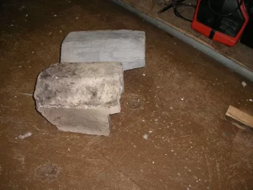

Just think for a moment the environment your nozzle lives in. Before you fire it is around let's say 100F. In ten minutes, it could be seeing temperatures approaching 2000F. This rapid temperature rise is eventually going to take its toll. $ 100 -$ 150 to me does not sound too expensive, if your replacement nozzle has already been cured.
Pictured below is the nozzle for the old Jetstream boiler. It costs $135.00. Changing it is not the time consuming part, the curing is what takes the time.
The worn nozzle has about five years use.

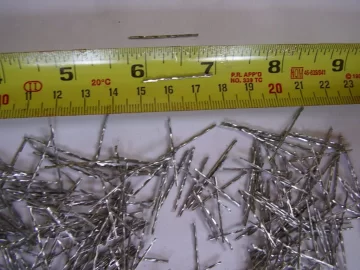

I have been making my own nozzles with good results .
Pictured below are stainless refractory needles ( refractory re bar ) used at 1 1/2 - 2 % percent of the mix .
A source for refractory cement and needles is: http://www.newhorizoncorp.com/
Another source for refractory cement is: http://www.budgetcastingsupply.com/Castable_Refractory_Kast-0-Lite-26-LI.php
