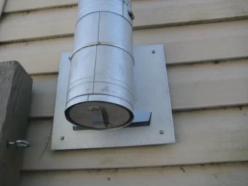

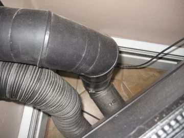

Can someone tell me why some have Condensation issues while Having an OAK and others like myself
are Always bone dry inside around the OAK tube.

Could be a dry home with lots of leaks is one possibility. Are you implying that yours is heated from your exhaust vent? Which I think is the case.
Think I will start with just insulating the oak and then go from there,give everything a shot until I get it figured out,something to think about though,don't blame it on the pellets for clinkers until you know what your stove is taking in
The horizontal flap on pic#2 under the cleanout looks to be it. I'm sure he was going to tell you but I don't see the need to wait lol. Or maybe I'm wrong.
yes...under the flap is a row of small holes bring in the Outside air..
with the exhaust right next to the OAK tube I assume it picks up the heat...
