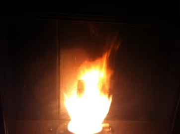

I did a hard reset and cleaned out the entire venting system. I opened the side panels on the stove a bit for more air and de-winterized my basement. My stove seems to burn better. Let's see if this helps.
My baffles were completely black from the burning issues, but they seem to be getting lighter.

Flame looks big and lively. But any black is a bad indication. IMO
