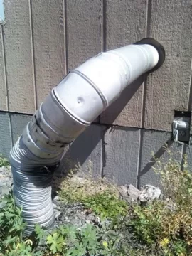

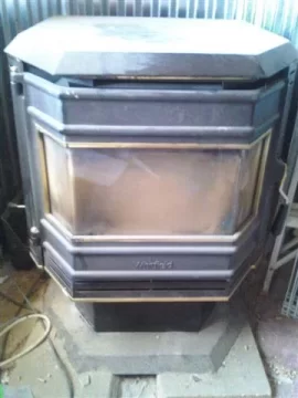

a customer sent me this picture, she was aking for help with a whitfield /i id'd the model as an advantage plus from another pic.
i'm advising her to add a tee, and run the vent up above her roofline...

Dear Dave, this is the stove I had a fire tragedy with. During 80-100mph winds the fire in the pellet box traveled up the auger and caught 40lbs of pellets on fire in the hopper. When we came home that evening smoke was rolling out of the walk out basement and the upstairs. We have been dealing with the smoke damage ourselves because we have a $1000.00 insurance deductible. The boys in our family have turned the basement into a construction zone so it is very dusty, and I haven't cleaned it all up all
summer.
On the outside pipe, we have tried many different caps and contraptions. In Victor Colorado above us they have a "H" designed pipe on stoves and chimney's or one that is shaped in an "A" design because of the high changing winds; which I can't find in one piece. Even the place we bought them from originally sent up his man to help and he had problems getting the adjustments set where it wouldn't turn itself off.
quote
summer.
