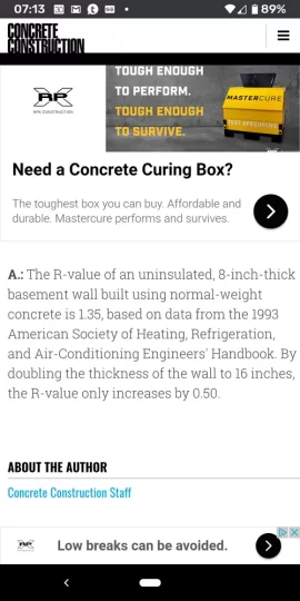

Concrete r value is pretty low. Also, double the thickness doesn't double the r value!
  • [Hearth.com] OK to pour concrete directly over Micore?
