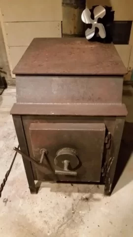

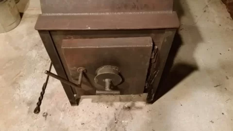

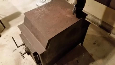

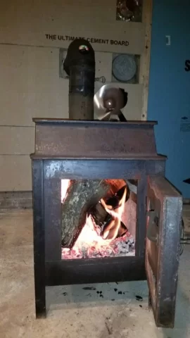

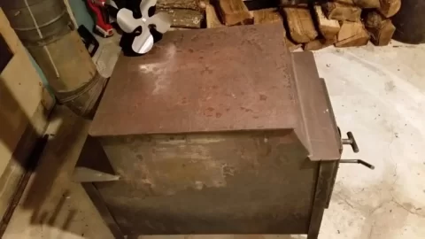

Hi all,
I purchased a small cottage in southern NH that was moved here from MA in 1940. Nobody actually knows when this house was originally built!
The elderly lady i bought the house from said her deceased husband had used this stove for decades.
I've had some people tell me it was a home built stove, but i am not sure. There are zero markings anywhere on it. Prior to me purchasing, the stove had not been burning for over 10 yrs. I did a LOT of cleanup, changed out the firebricks and .........wammo........no leaks, and burns like a beast!
[Hearth.com] Old stove - new owner - any guesses? [Hearth.com] Old stove - new owner - any guesses? [Hearth.com] Old stove - new owner - any guesses? [Hearth.com] Old stove - new owner - any guesses? [Hearth.com] Old stove - new owner - any guesses?
The burn box is H U G E (to me anyway) at 30". It puts out a ton of heat.
The seams are all welded.........thats all i've got for ya.
Any guesses?
Thanks,
Mark
The original design started with Bob Fisher in Springfield OR 1973. He was a laid off welder that is credited with building the first steel plate stove also being "airtight". Before that cast iron was the material of choice. His step top idea was to make the outlet higher than the door to prevent smoke roll in when opening the door. The tops of the early stoves were a 3 piece design like yours without the step on the back. For ease of production and speed they went to a one piece bent top, but those in private shops without a bending brake welded the tops in pieces like yours. I'd guess it to be a homemade copy. The front of yours is shaped like Calvin Cotton's idea who was a Fisher licensee that lost his license building similar stoves to the Fisher and became Timberline. The Fisher Forum gives lots of tips for operation and the Fisher Stove Story in the Sticky section at top gives you a good idea of the competition and the beginning of the modern day stove industry.
The legs look a little short to be the 6 inch minimum for unlisted stove floor protection standards, so it should only be used on a non-combustible surface such as the cement it's on.
The T on the intake is to be able to use your foot to adjust without burning your hand, and you can get a spring to keep the door handle cool.
Papa Bear takes a 30 inch log and heated approx. 2000 sf and Mama Bear takes 24 inch and heats approx. 1500 sf. That was calculated for insulation and windows made back then along with 8 foot ceilings, for Seattle Washington climate. That gives you an idea of heating capacity.
If it doesn't have a baffle inside, (if you can see out the pipe from the front door) any type of baffle plate inside is a huge improvement for efficiency and smoke reduction.

WOW !!
thank you for the in depth review!
This stove is a little tricky to run and i'm sure its not even close to the efficiency of newer stoves.
It does have the baffle plate. I can run the stove overnight if i stuff it full, but thats quite a bit of wood/fuel used also.
