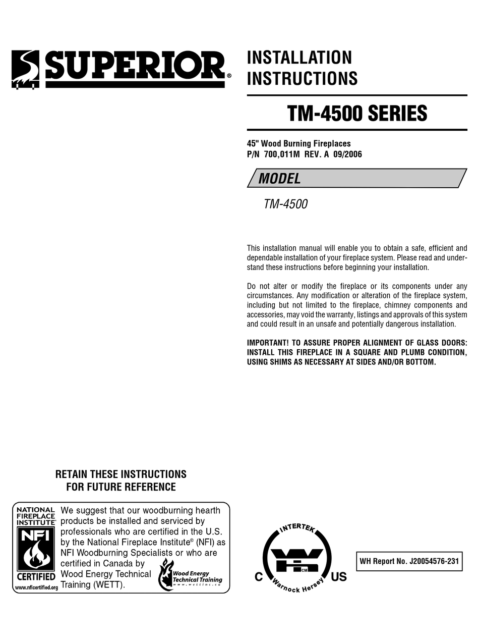

Your fireplace also has to be compatible with inserts as well. What model is it?
Hello. I found the manual in the paperwork from the original owner of the house. It's a Superior TM 4500 (or maybe TMC 4500).
The Manual states: DO NOT use a fireplace insert or any other products not specified herein by the manufacturer for use with this fireplace.
I can not find any mention of an insert recommended in the manual.
Two options may be to put a rear-vented stove on the hearth and extend the hearth to meet the stove requirements. Or surgically remove the current ZC from the rear and put in a new, EPA fireplace designed to really heat. This latter option will be expensive.
Do you have the manual? I can't find one for that model. If so does it say inserts are allowed?
@begreen - where do you see that in the manual? I believe you :) but don't see it.
@bholler - I'm sure begreen is right that the manual has the warning he mentions. So, fooey.
