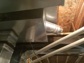

Ludlow, it would be nice if you referred to the poster by name. I had an open air return from the out doors without restriction, basically an open 6" pipe into my cold air return. My basement was around 45 degrees. Had I kept it open, it would have provided combustion air for my wood stove.

Ludlow, here's whats left of mine, a 6" insulated flex duct was hooked to this stub, and ran to an outside vent with no flapper, the cold air streaming in was ridiculous, especially with the wood stove going, and a north wind.
