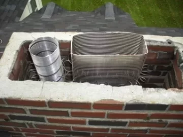

What type of construction was the liner? The one on the right or the left?

Ok that is light wall they are much larger od than id it is probably a 7" liner
Could be. From my notes, the circumference was 23.5", which works out to 7.48" diameter. I couldn't measure the inside as easily as it had ovaled. It all works now. When the season ends, I'll look at the top. It isn't that old, and the WW didn't burn so hot. From the websites I found, higher temps could shorten the life of stainless steel:
