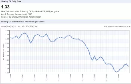

$1.49 here currently. I filled my tank back in Feb for $1.29 when oil was at a record low. Do the math. At $259 a ton pellets are almost double the cost.
  • [Hearth.com] Over $200 a ton = more expensive than Oil

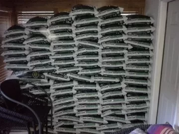

Same here, burned maybe same amount, have not cleaned my stove in 2 yr's, don't miss it either, here's a pic from 2 years ago I saw on my Facebook page memories
