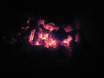

Last night the low temp was 24 so I loaded up the T-5 with all red oak. I woke up to the house at 78 degrees and a load of glowing coals 9 1/2 hours later.. To me this is way too warm but the stove air is all the way down. Seems my options are to run smaller loads or run less oak mixed with lighter wood. Overnight burns mean little if it's too hot to reload after running.. Anyone run into this problem and how did you resolve it? I am glad I didn't go with the T-6 as I'd get baked out of the house.. This is a pic of the coals 9 1/2 hrs. after loading..
Ray

With experience, common sense, temp forcast and wind etc, you will figure it out.
But a couple ideas to dick with:
1. Don't "load it up with all red oak" when it is 21 degrees, maybe mix some other species of wood, or don't pack it to the gills
2. Reduce or shut off the blower
3. Nothing wrong with letting it burn out overnight -- ie for ash cleaning.
4. Check your thermostats, maybe one of your family members turned up the heat.
5. Sleep naked
6. Relocate further north than Taxachussets or Put an addition on the home

Thanx for the feedback madison! I have the blower at 25% speed and the temp is uniform between up and downstairs . Shutting the blower off will just make it hotter downstairs. Part of the problem is that nobody wants the cats in their room so they close the doors so that reduces the heat load somewhat. My T-stats are set at 62 not sure if they can even be set at 78 lol.. I already sleep naked maybe I need to remove my skin? Seems my only solution is to user less dense wood and/or a mix of the several woods..
Ray

Part of the long coal life I feel is the way the stove burns from front to back.. This leaves the hot coals pretty far from the air source and they live a long time with just enough air to stay alive.. I don't have much cherry and pine so I can't make the claim with the T-5. I burn harder denser wood so it's not a fair comparison of burntimes between T-5 and T-6 (of course the T-6 is 50% larger so it will burn longer).. The thermal mass of this stove stores and releases heat for many hours after the fire has burned down much better than my CDW did.. The cast iron panels on these stoves is heavy and while they do not get extremely hot they absorb very well..
Ray

Yeah I agree with what you are saying I think they hold coals for a very long time in the back of the firebox and then release heat vie thermal mass. I bet it takes those 5 splits I put in to really heat the whole mass of the stove back up good. and then I will load it for the night on a nice coal bed.
