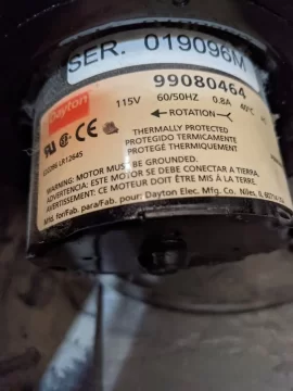

This brings up a good point. The Harman room blower motors are sealed as in picture. No way to lube that I can see, Any suggestions ??
Reactions: Washed-Up
should be a dust cap in the circled are the other end you will have to take the squirrel cage and housing off to oil[Hearth.com] P43 motor or fan?
should be a dust cap in the circled are the other end you will have to take the squirrel cage and housing off to oilView attachment 272659
Exactly and while you have it apart, blow the dust out of it. None of the bearings on any unit are 'sealed' Bearings have a dust seal and you can remove it with a pointed tool like a scriber and oil the bearings and replace the seal. Companies that build the motors won't go to the added expense of using hermetically sealed bearings because of the expense. They are pretty costly.
