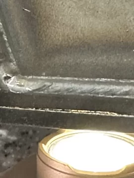

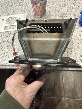

I removed the new pot and after inspecting, it’s defective. There is a gap on the bottom between the flange the bolts bolt to, and the rest of the pot. I am assuming this should be welded. New one ordered.

I'd like a picture of that, you can post it here. Also, was it a Harman, or aftermarket?
First time I have done aftermarket. And the last. You can see the light shining through. I think this occurred partly due to that flange warped a little.
