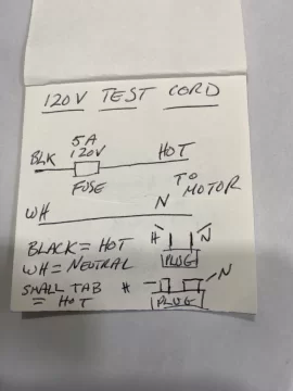

Another option is re re-test each item with a fused test cord and with an AC amp meter in series (most meters have AC current mode) and test the currents drawn. I have those currents documented in my other post. Test mode will run most, and do the igniter manually.
Also measure the total current. The new stoves have one 5A fuse on the board. The auger/feed motor should be moving pellets for the test.
