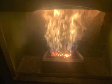

It sounds like it’s working the way it should, trial and experimentation is one of the best ways to learn how your stove operates optimally...and here a photo of a normal burn on my P61A...2-3” from the end of the burn pot is pretty normal

That’s about where mine is at. I shut it off tonight because I don’t like how hot the wall is getting on the one side. I read the install wrong and thought I had enough space. The dealer that sold me all the piping and the stove said I was good to go so I positioned the stove in the corner where I wanted it, with all the piping I had and it sits 12” from the wall on the right side. Specs say min 13” without shields and 9 with. I thought it was just 9. So I’m going to call and ask about shields for it tomorrow. I can’t find any online.
