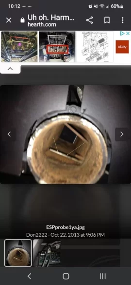

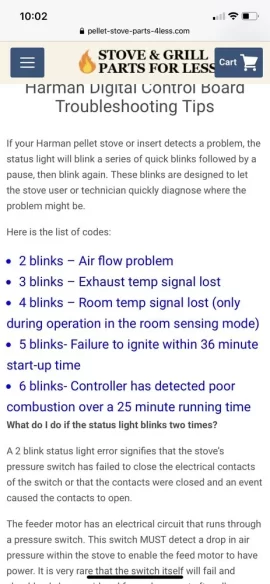

3 blink code is the ESP probe. It is the silver probe in your exhaust tunnel. The control board is not reading it. Un- plug the stove for a minute to try a reset. Pull your ashpan out and remove the blower cover. The probe may have lot of ash on it so gently brush it. If same problem then the probe is bad and needs replacing. Possible that the control board is bad but that would only be if u replaced the ESP probe and still have this problem. So in that order, clean the probe, replace the probe, replace the board. P61A owner. 8 yrs.
