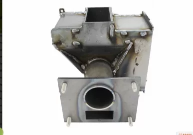

You either get it welded or buy a new part that is called a feeder weldment.
(broken link removed to https://www.stove-parts-unlimited.com/harman-feeder-weldment-old-style-1-10-677150-p/1-10-677150.htm)

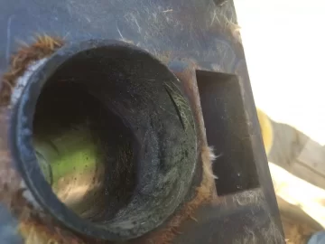

This is what the crack looked like in the weldment I replaced. It was on a Harman Invincible.
  • [Hearth.com] P61a smoke in hopper
That auger tube is about 1/2 as thick as the one in my 6039 is. Think I'd cut it out and replace it with something heavier, like a schedule 60 tube. That looks to be schedule 40.

Interesting about the tube. My 6039 is pushing 15 years and there is no wear in the tube whatsoever. Curious as to what causes it. Is it an inherent design flaw that mis aligns the auger in the tube or what?
If it was me, I'd cut the tube out and replace it with a heavier wall tube with the same ID. Not difficult to do with the proper tools.
The auger tube and weldment in a Harman are completely different than a USSC. I don’t have a plasma cutter or a mig welder in my arsenal......it was much easier to buy the weldment new.
