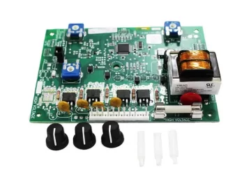

It could be a potentiometer that has a bad/intermittent connectivity near the off position. Some have had luck with contact cleaner on these devices making them work better. Obviously this has to be done with stove unplugged and it's not easy to get cleaner inside these little blue "pots" .

Did you try cleaning the blue knob controls (potentiometers) on the back of the board with proper cleaner ? Looking thru your older posts it's a refurbished P61A, has the ESP ever been replaced ?
What do you mean by blue? No I haven’t tried cleaning the potentiometers. I was thinking that they were working (at least the temp/constant/off) because when you turn it to off the status light shuts off so to me that meant the knob was in the right location to turn off and the stove knew that it should shut off. I don’t know if the esp was replaced or not. I attempted to fire it back up last night and couldn’t get it to ignite so I left it off. The burn pot felt warm so I think the igniter was working but for some reason wouldn’t fire up after 2 attempts.
Clean the esp. that is the boards only indicator of heat in the stove.
Blue Potentiometers on board for controls
