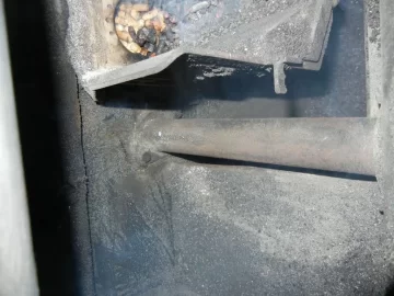

What i mean is a tube in the back of the stove that runs from the from the fresh air chamber to the feeder unit. Something like this.
[Hearth.com] P68 Flame
This will not be exactly what you have as i installed this myself, but you may have similar if it's a stove made in the past few years.
The reason I ask this i because I just installed this bypass on mine and have noticed a similar effect on the burn that you have stated. My burn changed from before the bypass install to after. If you are used to seeing a flame on stoves without the bypass it will be different on stoves with the bypass - you may be noticing this difference. The bypass allows some air into the augur chamber to stop the back up of gasses causing other problems. This air in the augur seems to be allowing the pellets to start burning farther down the burn pot than previous models of the stoves. The air coming out of the augur chamber flows over the low down burning pellets and carries the flame with it and "over" the front pellets. Mine used to do this like Harman Lover's only during a real low burn. Now it does it all the time. This is a result of the intake by pass tube. Is it ok? Don't really know. But since the stoves come from factory with it now it must be alright - i hope. I do find pellets burn at the end of the augur tube on low burn which i don't like, they should only burn in the burn pot IMHO. But the trade off is no hopper smoke.
That said another cause may be a leak in the hopper - the top seal, seam silicone, silicone where the hopper sits on the feeder unit, etc. An air leak from the hopper will do the same thing as the intake bypass and allow air into the augur chamber and then carry the low burning pellets flame over the front pellets in the burn pot.
