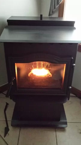

Here is a pic of her installed and running.
Definitely a great deal. Looks to be in excellent shape.
Looks good - now just need a hopper extension.
