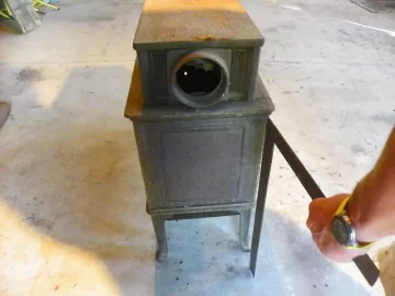

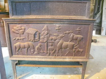

So would you guys recommend a stove paint or stove polish to bring back some of the exterior beauty of an original Jotul 118? I picked one up for a friend which I noted in a different thread only to find that he was given a free stove and was no longer interested in the 118. I decided before I sell it I will do some refurb and then sell it as a nice looking unit. I plan to scuff the sides/top/back etc. and am looking for advice on both the scuffing and the re finishing (black) of the stove.
Thanks!
Nate
Pics for reference...as you can see it is going to require some elbow grease.
Nate

I would think paint for that puppy. Check out Coaly's threads on what he does with the old Fishers, blasts them with walnut hulls or sumpin!
Go over it with a wire brush and a wire wheel brush on a drill. The clean off the surface, vacuum all dust and degrease with lacquer thinner or alcohol. Spray it with Stove Brite - outdoors or in a very well ventilated area wearing a mask.
I agree with BG. that stove looks like it should turn out nicely. Did you figure out what you'll be selling it for?
If this is for resale, I would paint it satin black. Colors are more of an individual taste.

Alright so I'll clean it and wipe it down with thinner and then I can paint with black stove brite...thanks guys!
