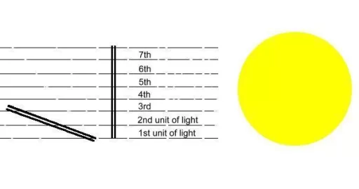

Not too difficult to figure out. The first 10 degree off don't matter much but after that it does. Seeing that in the summer the sun is out much longer and is more intense any bias should be for maximum summer efficiency.
