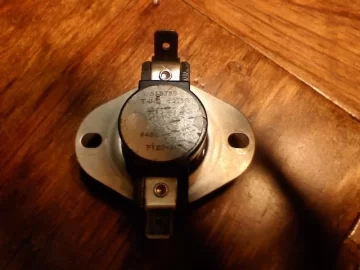

I have a 5440 pellet stove. It was running great until. I contacted the manufacture and they don't make it or parts for this stove. I tested the pressure switch and it was fine. Then I bypassed what I believe a relay or micro switch. It appears it controls the augur motor. When I bypassed it everything worked fine. Does anyone know if I can change this out with another type. I don't think I will be able to find the same one, since as said before they don't make parts for this stove anymore.

That just looks like a common snap switch to me. The rating should be on it somewhere. You should be able to mount any similar type there and make it work. If you can see the model number or any other on there for that matter try Googling it. You might just land on one that way. Graingers probably has them and someone put up a link a few weeks ago to a place online that sold stuff like this really cheap but I can't recall it offhand. You might be able to get one by taking it in your hand right down to the local plumbing heating supply. Not Lowes or HD but the places the plumbers and contractors get their stuff. That is a common off the shelf part used in lots of furnaces, heater and the like and surely they catalog something that will match or replace it. If its hooked to the auger motor I would say you have either the high or low limit switch that stops the auger motor when the pot is too cold or if the fire gets too high and it is overheating. There should be a number printed on the side, top or bottom to give you the degrees and it would be called a HI LIMIT or LOW LIMIT snapswitch.
If you can't find one locally or get more specific info here try the iburnpellets and iburncorn fourms as all these stoves use very similar switches.

Simple low temp switch... $20 or so... The Whitfield low limit, which could fit, is ceramic, a bit heftier. $38 - $45. They should last several years. Someone on E-bay is selling the Whtifiled ones...he might have the other switch. They are on a few pellet stove parts sites.
http://www.hearthtools.com/pellet/2000.html One of these should work.
You can jump them until a replacement comes... just make sure your stove fire doesn't go out as the auger and will continue to run without a fire.

i'd bet the one on your link would work, PM rod (hearthtools) he could probably tell ya for sure and at under 20 bucks its not exorbitant enough to be out much if it doesnt work. if it is the high limit switch though you do need it to be functional bypassing this function can lead to damage to the stove from warping or overheating the exhaust blower which normally would shut off if it gets too hot, this can lead to a rather unpleasant episode of smoke in the house, which we try to avoid as its bad for the image as you can imagine ;-P
