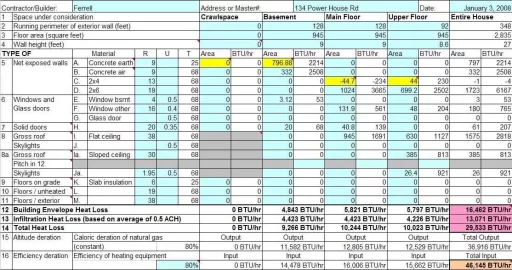

Heat Loss Calculations:
Building Envelope Heat Loss 16,462 BTU/hr
Infiltration Heat Loss (based on average of 0.5 ACH) 13,071 BTU/hr
Total Heat Loss 29,533 BTU/hr
Total Output 36,916 BTU/hr
Total Input 46,145 BTU/hr

If your heat loss calculations are correct you would need roughly 85 pounds of pellets per day just to heat the house and that doesn't include your DHW. Your post mentioned that there is a coil in the oil boiler so I'm assuming DHW is done by the oil boiler.
Also, you don't mention what temperature you are keeping your house heated, if the house maintains a constant temperature or if you turn the temps down when you are not there. That plays a big part in fuel usage.
Since you gave me the necessary information to calculate your heating degree day temperature for Test One I can say your pellet usage is close to what I use on similar days. During a week day with a 53 degree day temp I use 2.5 bags of pellets and on a weekend day with the same degree day temp I use 3 bags of pellets.
Where you and I differ significantly is that my PB105 heats my DHW so I would expect you to actually use less pellets than I do for the same degree day temp. Also, even though we are heating roughly the same square footage you have two stories so you will have less heat loss from the first floor to the second floor since there is less of a temperature differential between the floors.
I am only heating the first floor. I have R38 in the first floor ceiling but the attic roof and walls are uninsulated so I should have a greater heat loss since the temperature differential is greater in my case.
I think you mentioned in an email you typically use 710 gallons of fuel oil to heat your house. A rough estimate of how many pellets you'll need to get through the heating season is 1 ton of pellets for every 100 gallons of fuel oil. In your case you should use about 7 tons of pellets. Take your average daily usage and multiply it by the number of days left in heating season and see if you're on target.
