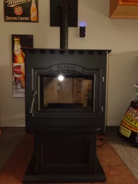

Here are some pics,This is in an attached garage that is my man cave.Wish I would of had pictures of it before hand but I didnt take any too eager to get to work on it I guess.

With all the corn in Iowa having a pile of pellets is almost sacrilege:) But with the lower heat needs pellets are a good choice and lots less ash. Needs something for the ash bin door.
Looks good and should serve well
I know it needs a little bling might work on that,I bought Somerset's for $189.50 a ton which is really good also have a lot of friends that are farmers.
Think they are made in Kentucky ... hardwood pellets. Bob, you probably see more softwoods where you are...
If you are looking for an inset on the ash pan, there was a place in Utah that would customize a slate to fit there. If you have a special photo you want done they can do that too. One member got one of his dog that turned out really well; one did his favourite football team. Think you can find photos of them on the forum.

You did a nice job on restoring the stove. Looks new. The $189 per ton price is excellent also. Looks like you scored all the way around. That stove has the capability to turn your man cave into a sauna. ;) It will heat it well.

You will likely still get a slight smell of burn off still on another fire. The initial is the worst but when you really crank it up in the cold that heat range will get the remaining paint burnt off. You did a nice job with restoring the stove. In the pics it looks practically new. I'm sure you have plenty of sweat equity into it but that buy in price was quite a score.
Good Luck with it and enjoy it. These old 45's are tanks with plenty of fire power.
When I brought mine home and went thru it tip to toe with some excellent guidance from Bioburner I had it on a temporary hookup out in an oversized two car unfinished garage with zero insulation and crappy garage doors which I put in two new ones since. It heated that entire space very well in some bitter cold. So your set up in a finished two car will do wonders. As I mentioned before you will not have any issue making your man cave as warm as you wish.
That said, beware because the sweet warmth will draw the other side into man caves. Ladies like it warm. LOL! My wife came out wondering how I was hanging "outside" in the cold so long and then figured it out. I had it warmer in there than the house running the stove thru its paces. I kept it running out there for about a month or so just because........
