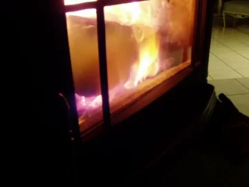

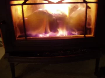

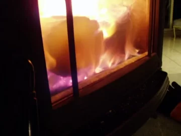

Took some pics of some pretty weird secondaries coming up the stove window from the manifold boost, the still pics sorta capture it....

I sometimes get the same flames coming from the boost manifold on my Super 27, usually when the stove is running a little on the hotter side. Hasn't seemed to bother anything.
