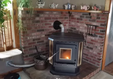

New contributor, new pellet stove owner. I replaced an aging Chubby coal stove with an Englander PVD 25 this year (2014). I had a well recommended local installer install the unit and it seems to work just fine with one exception.

Hope you have surge protection on your new stove ... We like pics;lol
Thanks Tim, thanks LakeGirl
We had our electrical upgraded a couple years ago and had a whole house surge protector installed.
