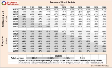

EcoHeat Solutions' EcoBoilers haven't been mentioned in this thread, but are a good option. The boilers are American made and competitively priced. They can pay for themselves with fuel cost savings within a few years. I have a biased opinion, but can comfortably say this is a solid, reliable heat source.
The boiler and burner need to be cleaned weekly, and this takes about 15 minutes. That's not such a big price to pay when weighed against the positives: saving money on fuel costs and keeping heating dollars local.
The storage units are sized right for most people. The smaller bin holds 400 lbs of pellets, and the larger one holds half a ton.
Attached is a chart showing the savings that can be had by burning pellets instead of oil or propane.
