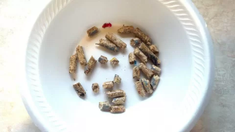

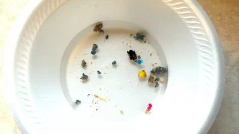

Some mills have been known to use Scrap wood, Pallet wood, Etc. This can lead to screws, nails, plastic, etc...
Here is a fine example of "Quality". :( I have burned 5 bags of this yrs pellets and No plastic to be seen? Yr over yr, a huge difference.
