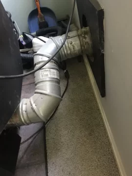

An EASIER way is to put 2 - 90 Deg pellet vent Pipes together and connect one end to your existing vent pipes, then rotate until the other end is at the proper stove height!! LOL Easy Peasy!
See pic example below of a Harman P68 that replaced a Harman Invincible RS which has a lower exhaust flange.
  • [Hearth.com] pellet exhaust  for the new stove
Yeah, that WILL work, but the stove location will be offset by 6- 8".
If that works for you, go for it.
