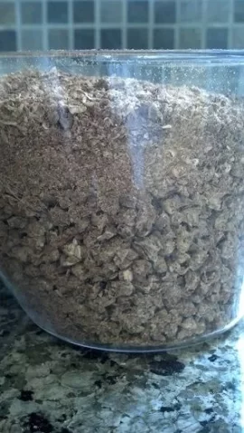

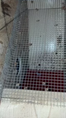

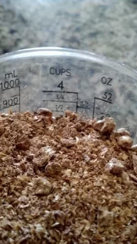

I sifted a bag of Tiny T'Embers today to test out this new sifter that I bought for $34. I separated 4 cups of fines from a 40lb bag. Is 4 cups considered excessive, average or, below average? Also, I'm wondering if I need to change the screen size? How does this compare to the size of fines that a pellet funnel vacuum separates?

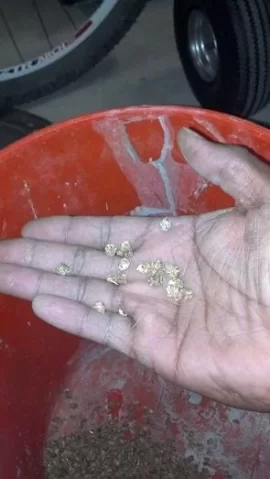

Looks to be more of a corn sifter. The 1/4 inch pieces will burn fine in the stove. Basically with pellets all you want to remove is the saw dust or pieces smaller than about an1/8" long pellet.

It is a dual purpose corn and pellet sifter. There's an extra screen that I would insert for corn. I think I'll tinker with it a bit this weekend now that I know the smaller pieces are still okay to use. Thanks.
Ditto what Jay said.....the pieces you show in your hand can be burned no problem. You need a finer mesh screen....all you want to remove is the fine dust.

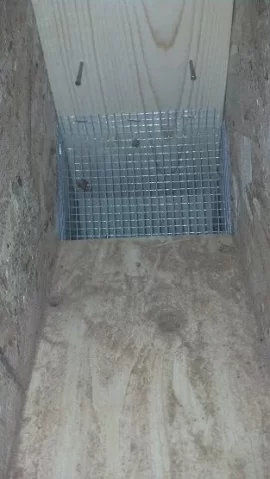

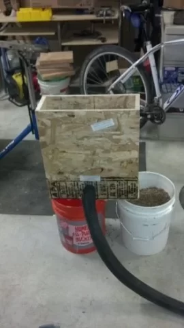

A finer mesh set at a steeper angle would probably make the process go alot faster with less of those small pieces being separated. I'll also give Corn Vac with 1 1/2" hose a try for comparison.
