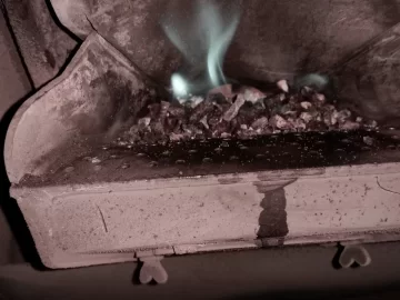

The flame stays low

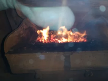

I've never had this issue before

Page 26 of manual talks about the ESP and room temp probe and the low fire. May be time to clean the venting? Or the ESP is shot or the room temp probe
You keep saying you run it on manual, but exactly what is on manual? If you could give us a shot of the settings on your control board, that would keep me from asking a whole host of questions. It looks and sounds like it is at an idle, but that would be on room temp mode.
