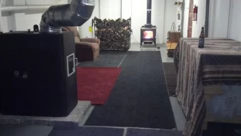

I love my Fahrenheit. But I run it in tandem with a wood stove right next to it. Some use a much lower heat setting than the other 3 Fahrenheit users here. And I am heating about 3,000 sq ft total

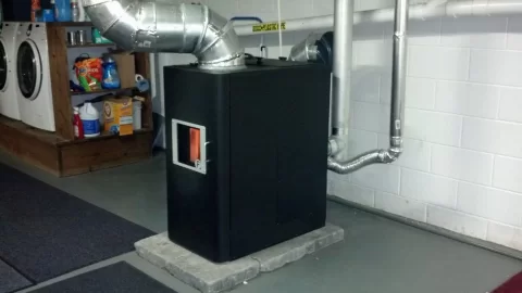

DexterDay - the pipe coming out of the top of yours, is that the exhaust or is that the warm air "plenum" of sorts and connects into your forced air system?

The big pipe on top is Hot air plenum with the Exhaust being 4" and Outside air being 3".
