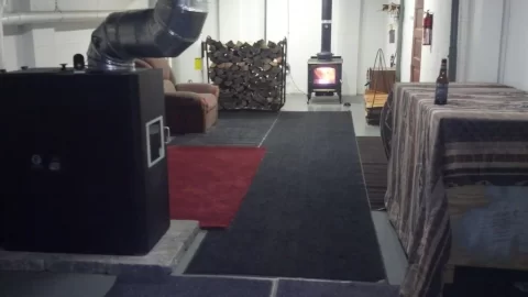

The Fahrenheit (I am biased as well) is a nice unit, although its only 50,000 BTU, it does not have a problem in my home (2,180 sq upstairs and about 800 sq ft in the basement where it resides). Granted I run a wood stove in tandem about 90% of the time when furnace is running. I have ran without the wood eater and it still does a god job on the same heat level, never used ver level 3 out of 5.
The St.Croix revolution (70,000) would have been my 1st choice if buying new, but I bought used. I thought I was gonna need a 70,000 unit and I am happy to say that I do not.
With the auto cleaning feature on the Revolution and Fahrenheit, it can run for FOREVER, without shutting down for cleaning (SCF-050 has a nice cleaning feature also) and with the multi fuel rating. All 3 of these can burn anything that's thrown there way.

Nice setup !! Your beer is getting warm though. Going to look at the Revolution Monday.
Thanks everybody for the information and pics!

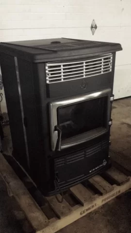

I recently bought an SBI stove (Enerzone, Drolet, PSG) and couldn't be happier. Very easy to clean. Easy to work on. Mine is still in the garage. Waiting on install. But I am excited and looking forward to the bottom feed system they use and the features the Eurostar has :)
