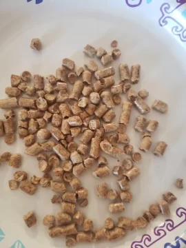

When i get pellets this small, i lower my harman feed rate down to 2/half.
  • [Hearth.com] Pellet length
Gives me same heat as long pellets on feed rate 4
Yep, that is what mine looks like, but darker. I already have my feed rate down on one. With trim set on one. It don't go lower than that. One upside is that this 3ton of pellets I just got should last 3 yrs...
