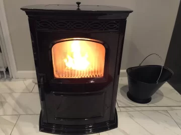

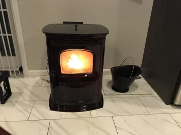

[Hearth.com] Pellet Production run [Hearth.com] Pellet Production run Instead of the Rutland glass cleaner try Wiseman (or any other brand) ceramic glass COOKTOP cleaner. I find it to be less expensive and it puts a slick coating that the ash doesn’t stick to as easily. I just took this picture showing my glass, it was last cleaned about 2 and a half three weeks ago.
Nice if I leave it for more than a day I can't see through glass... ash seems to be atracted to glass

View attachment 222873 View attachment 222874 Instead of the Rutland glass cleaner try Wiseman (or any other brand) ceramic glass COOKTOP cleaner. I find it to be less expensive and it puts a slick coating that the ash doesn’t stick to as easily. I just took this picture showing my glass, it was last cleaned about 2 and a half three weeks ago.
I tried the Wiseman cleaner the last few times I cleaned the glass and not seeing any difference. Twenty four hours later the glass is blurred out with ash. Maybe it takes a few more applications?
