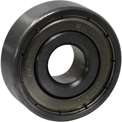

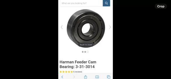

Please Note: The UL Feeder Cam bearing shown in the picture for $10 part # 3-31-3014 is the one shown in Bogib’s diagram 2.2 is 1” in Diameter. The auger bearing is much larger.
Does anyone know where to purchase the larger auger bearing?
I believe this is it. There's a part number too. Read down on the listing for a list of stoves. Your 61A is listed as compatible.
Offhand Don I know of no stove dealer that lists that bearing
Here In Ontario, I would take the old bearing to GBS General Bearing Service
They would do the measurements and supply you with the correct bearing
If there is a number on the bearing, it is even easier to find replacement
Good Luck
This may help. I actually wanted to have this for myself too. I recently ordered some metric bearings for my shop vac, and these are imperial.
