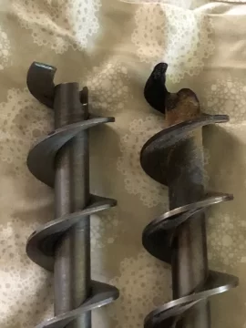

On my "to do" list for the last few years was an auger replacement for my PC-45. The stove is about 18 years old now. I bought the new assembly of auger and bearing earlier this year, and waited for a good time this summer to work on it.
Overall it went well. From the pictures you can see the old one was heavily worn at the leading edge. I think burning a lot of corn in the early years wore it faster, but I'm not sure. The old bearing was still decent, but had some front-to-back play and grease was oozing out, so it was a good time to replace it.
The main problem was getting the direct drive feed motor off the auger shaft. It certainly didn't wiggle off like the YouTube video showed. Penetrating oil and some vise-grips were needed to break it free.
Overall a good project to do over a couple of days. At 68 getting up and down from the floor isn't much fun anymore, and with a full clean and feed system check after I was done, it was a six hour job from getting the tools to when everything was put away and I was done. Stove is cleaned, spruced up, and ready for the burning season!

View attachment 348757View attachment 348758
