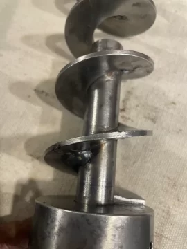

Anyone else seen this happen?
These augers are no longer made!
I just took the auger out and MiG welded the fins in 3 places with good penetration. Then popped the bearing seal and packed in some Red & Tacky high temp grease from Home Depot. :-)
The auger shaft now turns freely in the bearings.
Pic 1-2 broken welds
