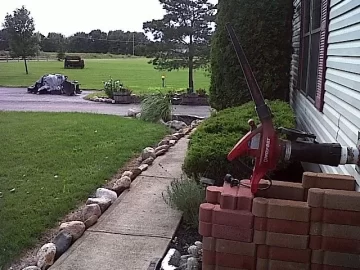

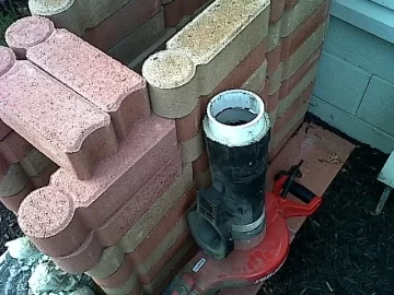

Have to be quick. My sons football practice is in 5 min. Here are some quick pics. You can see the PVC adapter (4" to 3") insidethe end of vacuum side. I cut back the vacuum tube, slid it in, and then Liquid Nail's it in place. I didnt put tape on the adapter to theflue for the pic. Again, in a hurry. You can see the Pavers. I move 2 of the top ones sideways to hold up the Leaf-Blower. Then when I am done. I move them back up.
