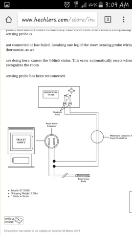

New to this forum and have a couple questions , I'm an owner of a pleasant hearth pellet stove model #PH50CABPS ( first time pellet stove owner ) i have had it for the second season now so far so good but was wondering if or how I can connect a wall mounted thermostat to the unit to further the efficiency ! any help/info would be greatly appreciated thanks in advance

Just did a search and haven't come up with any info , I also done a search just on Google and found something bout the Quadra fire thermostat for pellet stoves but wasn't specific to my brand and model email the company I got a reply saying it will work for my unit and showed a diagram basically placing the wall mount between the 2 wire temp probe and unit as run in a series

Specific to your stove, there is nothing in the manual to indicate a wall-mount can be used with it. The wiring diagram of the board does not show any connection. If there is a connection on the board, it will have a wire between the two terminals where connection would be made ... a jumper wire.
Not all stoves or control boards are created equal... could contact the company directly to see if it is possible. If you go that route, let us know what the answer is!
OK will do , thank you again , I will put any up dates I find with the situation
Do you run your stove in automatic mode now? Your manual shows that the unit will vary the burn rate to satisfy the desired temperature. If you install a room thermostat, you will only control the unit turning on and off, not the burn rate.
