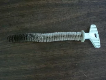

This is what I use. I bought it at the local hardware store. I didn't save the tag so I can't say who made it. It fits in between my tubes and I also use it to clean behind the exhaust panels on my Breckwell.
