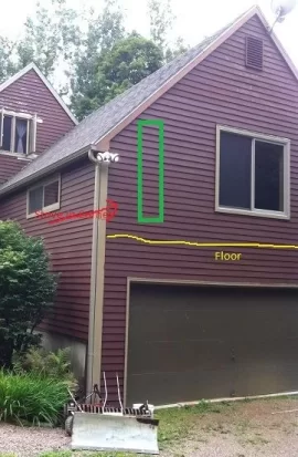

Here is a quick picture. The red arrow shows the corner the stove is going in. The yellow line represents the floor of the room. The distance from the edge of the window to the corner of the house is over 9-10ft. The floor is 24 inches below the window. Basically the green box represents roughly where the vent could come out.

Sorry,been away shooting speedgoats on the prairie.So some simple things,a straight through the wall is what would be called a"dirty install" quick,easy,safe.A out and up(even if 3 foot) is better) your house will accept that.An up and out in stall improves draft,keeps pipes cleaner.Just my thoughts,I only am trying to help.Your pictures show you can do anything,you are fortunate.Bob
