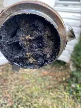

As a service tech I would want the exhaust in a accessible place. When I walk up on a call for a stove issue the first thing I do before walking into the house is pop the term cap off to check cleanliness of pipe and cap. This is a prime example. Customer complaint was that the stove would take a long time to light but would not stay running. He swore his auger motor was going out. :). Before I walked inside and started disassembling the stove and checking for voltage or doing a draft test ect. I pulled the cap and determined that there was a good chance the stove was fine and just needed cleaned.

The original post does not state the exact reason for concern or many details. Is the deck 2 ft off the ground or 8ft off the ground? The point I was making is the termination needs to be accessible. You would not want to be belly crawling back under a deck to service the pipe. And as we all know the pipe needs serviced regularly.

I have had a couple of vent pipe fires when the stove is cranked after a couple months of low fires. The creosote at the termination catches. Not a big deal, but I would be concerned if the termination is under a deck and there are actual flames coming out of the vent.

Thats not good. You need to crank it up more often to keep the creosote from building up. Or run it hotter for shorter times.
But yes that is a very good point

I heated with wood for many years and that was the one thing I did every single morning. 15 years ago, when I bought my first pellet stove, the word was that I didn't have to worry about creosote. Getting a call from my wife that there were flames coming out of the vent changed my thinking real quick. I sold the old stove (which was the root cause of the creosote due to poor design) and bought a Harman Accentra. I turn it down at night but when I turn it up in the morning it cranks for an hour to an hour and a half. I religiously check the exhaust venting and in the 3 years I've owned it, I've never seen any buildup on the termination. Still, that's me. Judging by your picture, it's not an all too uncommon problem.

I learned something new here today. So what you are saying is, run the stove at high heat for an hour or so to use the hot exhaust to burn off the creosote buildup?
I guess my answer is it depends. My venting comes out the back of the stove and goes up 8 feet then a 90 out through the wall to the termination about 18 inches out from the house. Creosote forms when the exhaust is cooled and the moisture in the exhaust condenses on the cold pipe. Over time it builds up. Especially on the screening at the end of the cap. When you crank the stove the exhaust is hot even out to the termination. If it's hot enough it will cause the creosote to expand and turn to ash. That ash can be brushed away. Now if you have venting that goes straight out the back or is not long the exhaust usually doesn't cool as much so there is not as much condensation. That said, cranking the stove for an hour every morning can't hurt

If the stove is idling for extended periods of time yes it is good to crank it up regularly. Before I converted my P38 to a P43 auto ignite, I would keep it on a low fire to maintain temp in the basement, So it was burning at a low temp 24/7. Then one day I kicked it up and had a small chimney fire. That is when I converted it so it runs for a period of time then goes into chit down then refires when needed. So it is burning at a higher temp when it is running.
