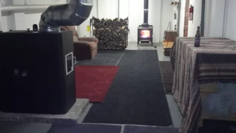

Pellet furnace (Fahrenheit Endurance 50F) in the foreground and Wood stove (Engalnder 30-NC) in the.background.

Back to the thread, furnaces have much larger distribution blower and dont need any inline assistance.
