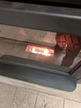

I dont understand why the pellets from one bag to the next from the same pallet would burn so differently. Most of the ash is dark gray. The stove burned like the video for about 36 hours, i then shut it down to clean it and then had a completely different burn, had to completely change the settings to even keep the fire going. Had to crank up the feed rate to 5 (in the video it was set to 1), and had to putz with the damper and combustion feed rate to keep the flame from going out the pellets were burning so fast with a brisk flame. If i had i creased the combustion air it would nkt have been able to drop pellets fast enough to maintain the fire.
Sometime this morning after i checked on it ( around 7 am) "something" changed, and when i checked on it around 11, i had pellet build up, partially burned pellets and a lazy flame. I raked the liner pot to dislodge the built up ash and it began to burn better. Shut it down around 230 to clean. What i thought was soot on the glass actually vacuumed off so im thinking it was more likely black ash. It is a persnickety machine.

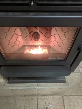

My current problem, and how the stove burned all yesterday... Not enough pellets to sustain the fire, then they ignite kinda all at once, burn fast and it almost goes out.

I can see in the first picture there’s a lot of powder in the chute that drops the pellets. That’s not a good sign. Your chimney set up is ok but I’d rather see it out the back and up. When you stir the pot your probably also dropping ash into the burn pot holder. Are you playing with the trims? If you are set them both at 3. I also forgot the ash pan has to be put in square or it will leak air at the bottom. Make sure the gap down both sides where the gasket presses against the stove is even. I have a feeling we may be putting up with another year of crap pellets. We’ve already gotten a couple loads of dirty ones. How dusty are yours?

I am playing with the trims, more than it seems i should need to from bag to bag. I will try them at 3 but i think it will be too much combustion air for the drop rate and the flame will extinguish.
I discovered the nissue with the ash pan myself...thats when imgot the awesome burn in the video.
I dont think of the pellets as being dusty, but i have no point if reference.
