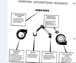

If your stove is Normal, then here are the Normal sounds!
If not, then call in a professional. :-)
