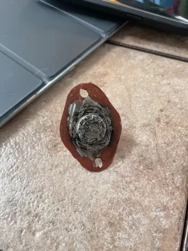

Hi temperature sensor 2 orange wires to it, red button in the center
mounted on the hopper wall right side at the top behind right outside panel
IT IS NOT INSIDE THE HOPPER
You may have heat settings set incorrect or your board has a problem
We took the sensor out and it was nasty. Full of crud! Look at pictures. We had a spare one and replaced it. Working well so far. Thanks for all your help. I hope this works
