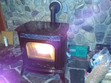

I switched out Blaze King King in 2018 for Harmon XXV (Non TC). Sure is nice not getting wood. So much easier to deal with pellets. But wood was almost Free. We had lots of trees that blew down and used those from 2014-18. Gave away 6 Cords when I bought pellet stove.
We live in 2600sq ft house and use couple box fans (get them now) to move around down the hallway. 74f in hallway. 68 in Bedroom. I use the Heat Pump until 30f at nights. We have been going thru 3-3.5 Tons of Pellets. Last year just over 3 Tons. I have them Delivered and placed in Bay of Building and use Tractor and Bucket to bring them up on porch. Cover them with Tarp.

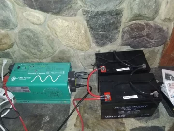

For Power Outages we invested in AIMS 1250 Inverter/Charger. One 100ah Battery gets me 6 hours. I have 200ah of Battery Power. 7kw Generator available to charge battery if needed. Longest power outages so far in 10 years has been 10 hours. Most are less than 4 hours. I run the stove at 1/2 fan speed in Manual Mode.
I got the Stove in April 2018. Floor Model. Got 1k off the Price ($3500 with Tax). Cost about $1200 for Install. Sold old stove for $450. Another 1k in Inverter and Batteries. Oneday plan on New Battery at 5 year mark. Picked up Cougar Vacumn on Ebay for $60 (needed filter).

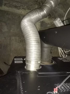

Every day I scrap the burn pot (30 seconds) and clean it every 1 Ton. Fines, Combustion Blower, Distribution Blower, Clean out Ash Pan and Igniter Area). Most of the time I do this when I clean the ash pan out. Holds about 3/4 Ton of Ashes. I have plenty of room to get to back of stove. Put extension on the OAK so not having to remove the tube and damage it.

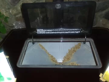

you get that worked out okay but where do your pellets go in and where are they--can't see anything that would hold them in the pictures..clancey...
Clancey looking at the stove on top is a knob that pulls a door open on the top where the pellet hopper is
behind the firebox. now that's about as clear as mud
Dataman post a pic. of your stove with the hopper lid open
lol I knew it had to be somewhere...That Dataman hid the pellets from me on purpose--just kidding--but the explanation is good enough. Now I would like to know how much does that pellet hopper hold anyway,,,Stove is very pretty,,,clancey
Yes Knob on top. About 1.5 Bags. I use 1/4 - 1/2 bag up to 1 bag depending on outside temp and inside settings. So couple days I fill it. But I top it off daily.
You wanted to see the Hopper. It's not being using until Sep or Oct. So Empty
